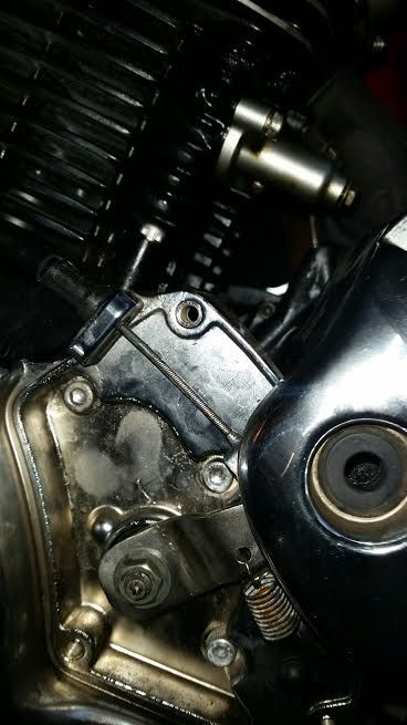

On my way home from work today I went to down shift, pulled the lever and felt a "pop"...then it was obvious I no longer was able to engage the clutch.
I coasted to the curb and killed the engine. Put it in neutral and pushed it down to a parking lot. I thought I snapped my clutch cable, and since I have a cable repair kit in my bag, I started removing covers to access the clutch push lever assembly.
Surprisingly, what I found was this.
Anyone else have your push lever assembly break on you?
Bike only has a little over 20K miles on it.

did you buy the bike used if so the previous owner might have installed heavier clutch springs that stressed the lever.
Yes, I'm the 3rd owner. I bought it from a friend of mine whom had owned it since 2006. I know he didn't change anything in the clutch, and the bike had only 2200 mile on it when he bought it. He says as far as he knows, it was bone stock when he got it.
All I can guess is there were defects in the stamped piece. After removing it, other than the break, you don't see any issues with it. On the back side is another story. You can see several stress/ fatigue cracks in the metal.
I was going to suggest that other owners inspect theirs for cracks, as to possibly avoid getting stranded by a $15 part. Maybe mine was a isolated case, who knows. Obviously it's not currently a common issue, which is a good thing.
I've already ordered a new one, but I think I'll order a second one to keep as a back up.....just in case.

I fabricated a new lever out of a piece of scrap 1" X 1/8th" stainless flat stock today at work. It actually works great, but the button head screw I had to use to attach the piece for the cable to hook into, hits the cover. If not for that, I'd probably just leave it on and be done with it.
So for now I'm just leaving the push lever cover off so I can ride until the new one comes in.
