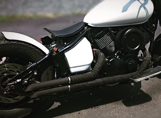

heres what I'm talking about, taking the back half off

heres how i did mine because i wasnt much on how long they were so i cut the mufflers off and bought a pair of turn down exhaust tips from Ebay to match my pipe size and welded them on and exhaust wrapped over the welds.

Wow! Looks awesome, notice anything different having the shortys on?
just louder lol but being i added the 13" extension tip onto the top pipe (rear cylinder) it eliminated that bobble popping sound. i did a small little write up on it. My piping was 1.75 so i bought a 16" of 1.75 exhaust pipe from advanced auto and the 2 13" turndown extensions from ebay and placed the exhaust piping onto the bottom pipe that way the turndowns would be at the same spot. sanded the chrome extension tips and painted them with matte black header paint then wrapped from the engine to the last weld at the tips with black exhaust wrap from amazon ($16 i believe) as far as performance no i dont notice anything, its doesnt pop downshifting bad at all just what you would expect, and an awesome idle

looks badass man! i don't have welding equipment but i imagine exhaust clamps will work the same? just buy the exhaust tips, clamp them, and wrap them? ill let you know how it goes and will send pics

Yea you could clamp it using like pipe repair clamps at your local pep boys the tips and the extension pieces are swelled to slip over you piping usually just measure your pipes not sure if what I cut up was stock size or not
