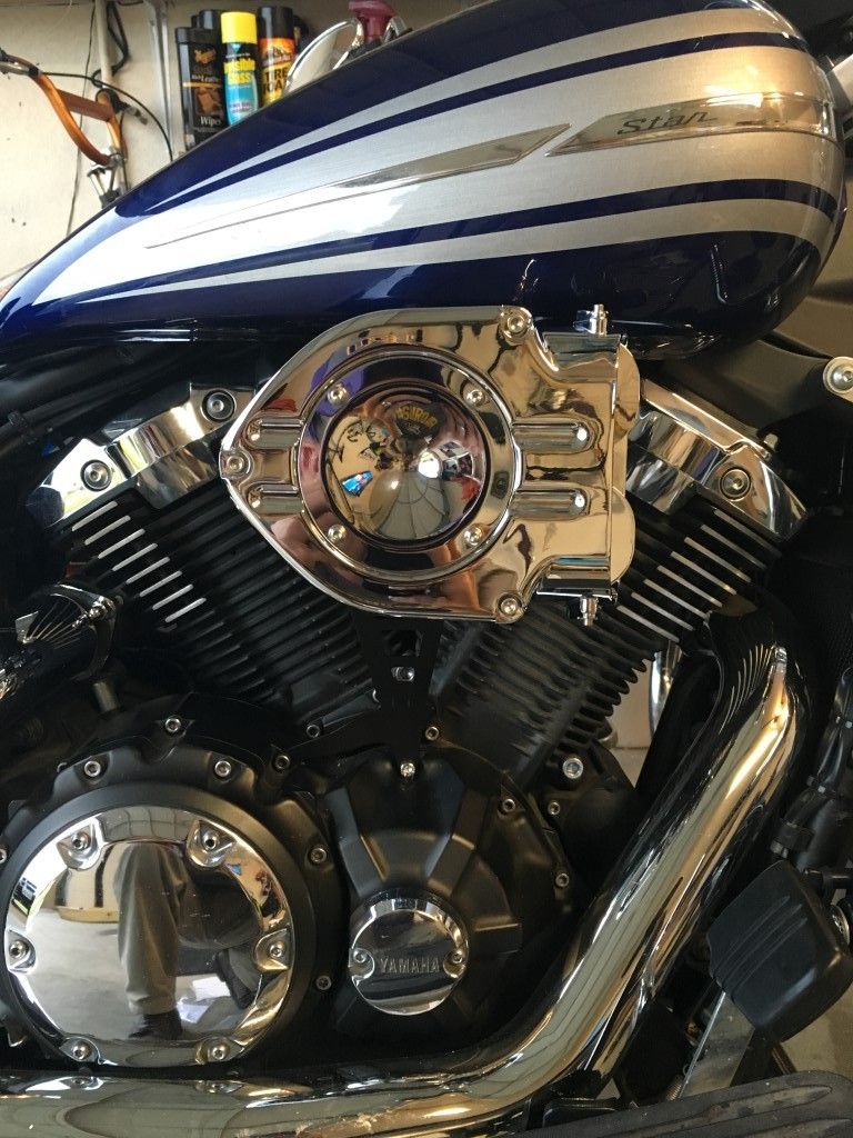

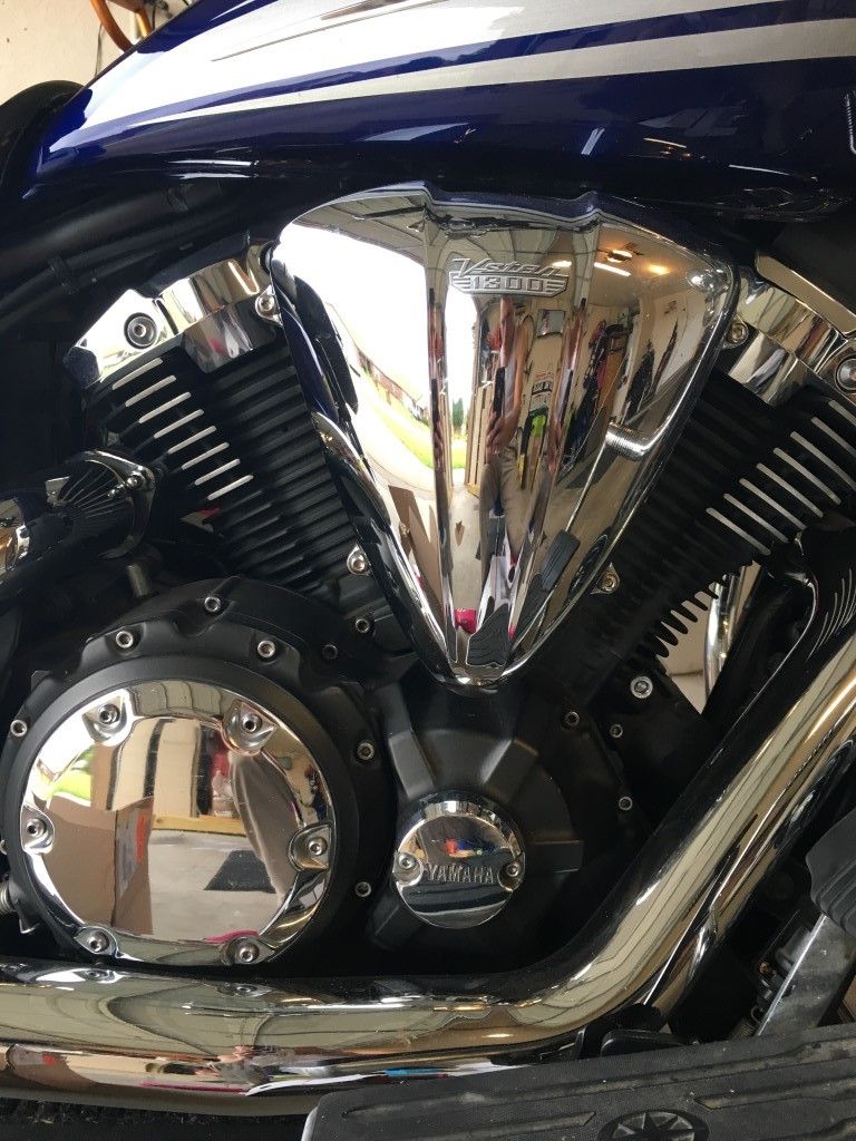

Opted for the hypercharger. Not real concerned about more power, more looks. Got this in today and installed with minor issues.
BEFORE
AFTER

Yep, I've always liked the look of that.
