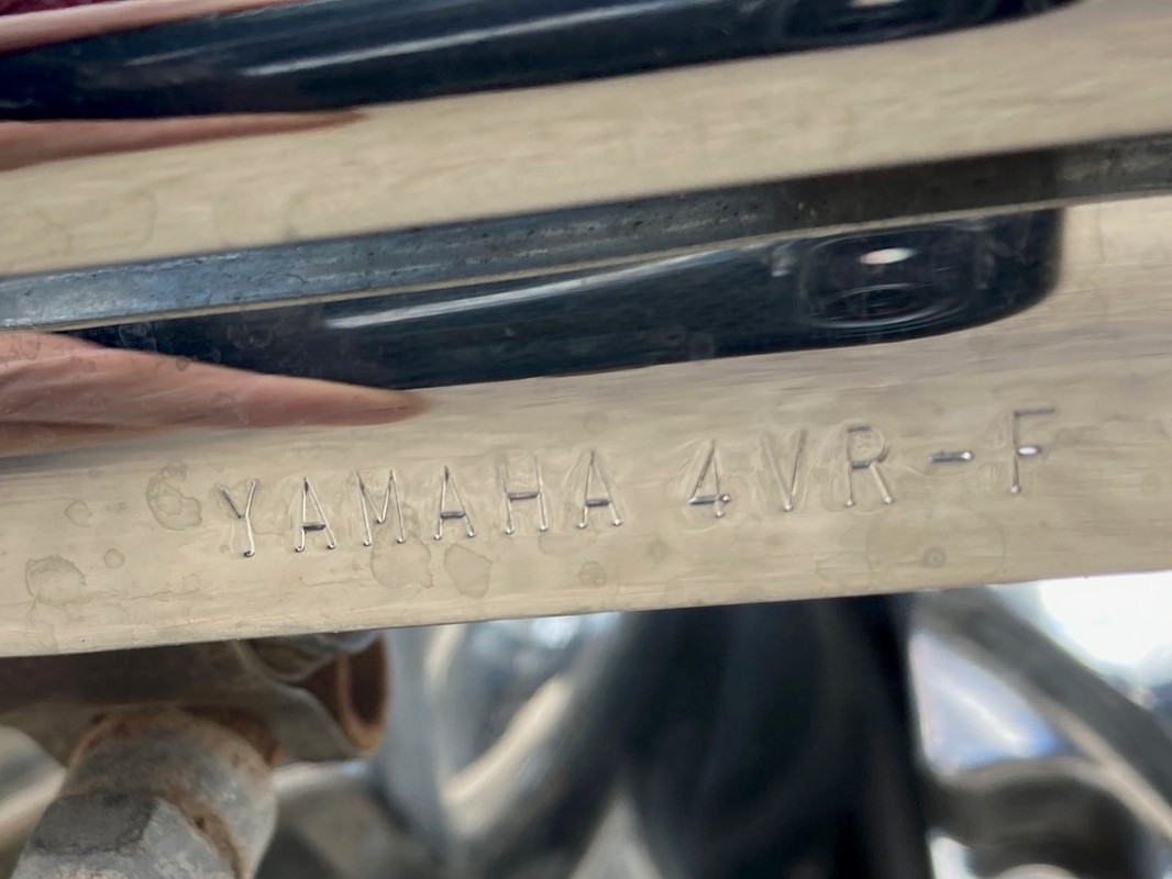

New to me bike with Vance and Hines exhaust. It came to me that way. Just getting a feel for the bike and have a few questions. I found the recommended shift speeds in the manual, does anyone know what the redline shift points are?
It does backfire mildly on decel and falters a bit at higher rpms. Both to me say it's a bit lean. Is it normal to have to rejet with this exhaust kit on the bike? I have yet to go through the carbs to find out what's in there for jets. And I have no idea what's been done to the bike. PO could offer no info.

Does your bike have the stock air filter installed? If it does, then you can likely adjust the fuel/air mixture using the PMS screws to reduce the popping and richen your mixture slightly. V stars are apparently a little on the lean side from the factory.

Is the Yamaha stamp on your photo on the exhaust? If it is, then you actually have gutted (or partially gutted) OEM exhausts... Basically someone has cut the end off of the OEM exhaust and removed the some or all of the baffles and possibly the catalytic converters too. Can you post a photo showing the inside of the exhausts from the rear of the bike please. This will help determine the level of modification that had been done and may help us to advise what steps you should take with your issue.
This one is an 02. I heard catalytic converters didn't come until later?

Yep those are Vance and Hines, at lest from he header pipe back. They were too loud for me. No cat ,no balance pipe between. My 99 came with those same pipes and it is too lean.They will pop on deceleration, even the stock ones do, it's just that it's louder. Watch yourself with those heat shields, they aren't as good as stock. I melted holes in two riding pants on those "heat shields".
Good luck dialing it in, 650 CC&D is a good resource.

650 ccnd website has details on rejetting for most combinations of air intakes and exhausts. But they all assume you have a non OEM air intake... For the stock air intake, you can adjust the PMS screws to make minor adjustments.

I had stock intake so I made one of those minor adjustments. PMS screws and I raised the float level about 2mm. I know, I know, not really the proper way to richen it, but it worked!
