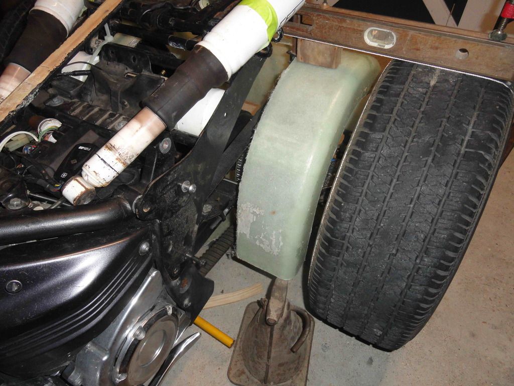

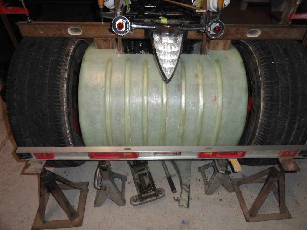

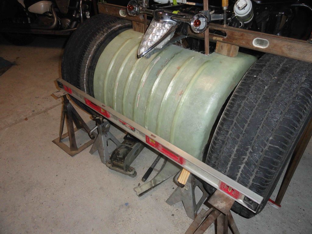

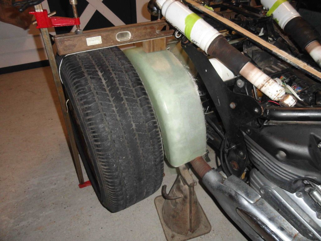

Worked on the epoxy glassing of the center section for my trike. First attempt fizzled and ended in the garbage can. Live and learn. Decided to go the old and proven way by tapping the laminates down with a paint brush and just working the resin around. I mixed up 184 grams of epoxy resin at a time which I could saturate the laminate mat just as the pot life was being reached. Kept doing that over several hours, let it set a while, and placed it mold in the sun. Put it in the garage over night and popped it out of the mold today and almost peed in my pants it came out so good. A few minor repairs to do, wash the PVA mold release off, and sand, then paint. Here are a few pictures showing it sitting in place on the bike. Will finish the mounting tomorrow. When my fiberglass supplies arrive, two fenders are next. The tail light is in it's temporary location to continue riding while working the bike.
