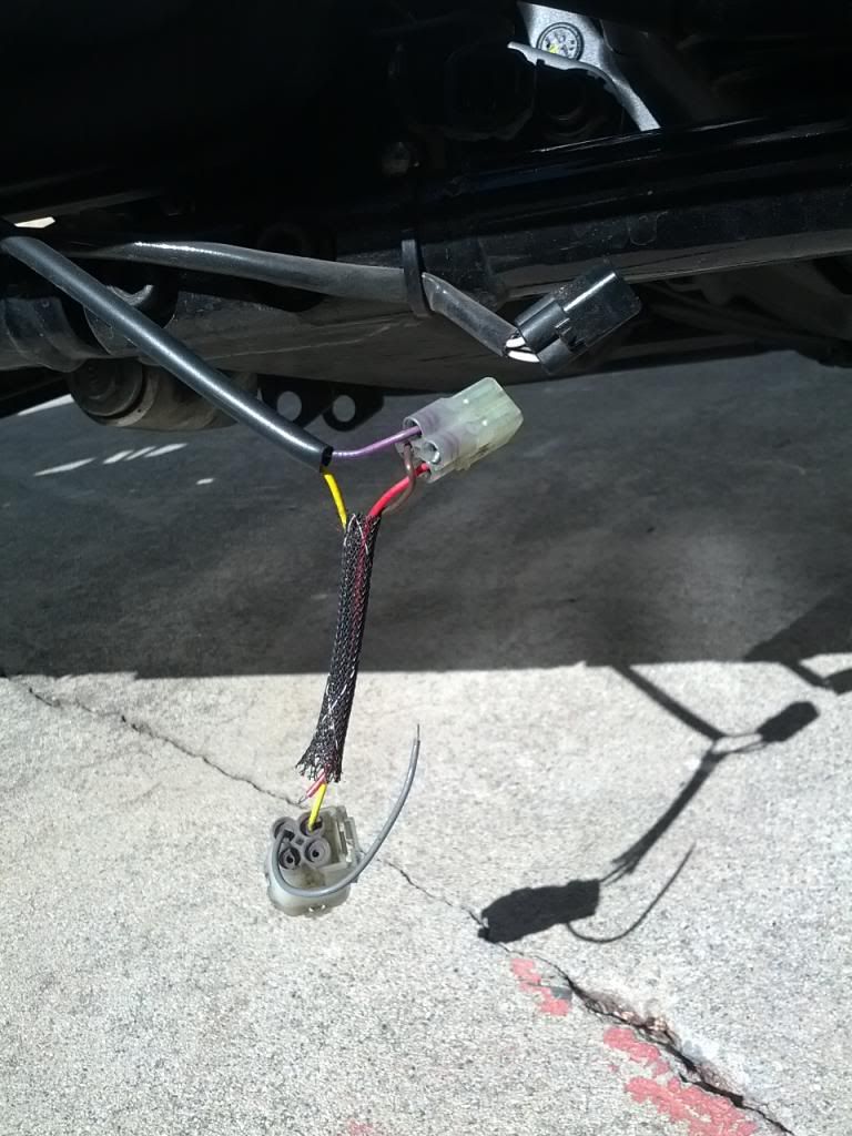

A few of the wires have been cut from the connector. I'm not sure how it happened but I would've like to fix it. Can anyone fill me on where the brown and red wire go?

for the wires, i would just call Cobra. mine are in the middle of the engine and a pain to get to in order to confirm.

gray wire goes to the right of the purple, brown wire goes to the right of the yellow and the red goes below brown
