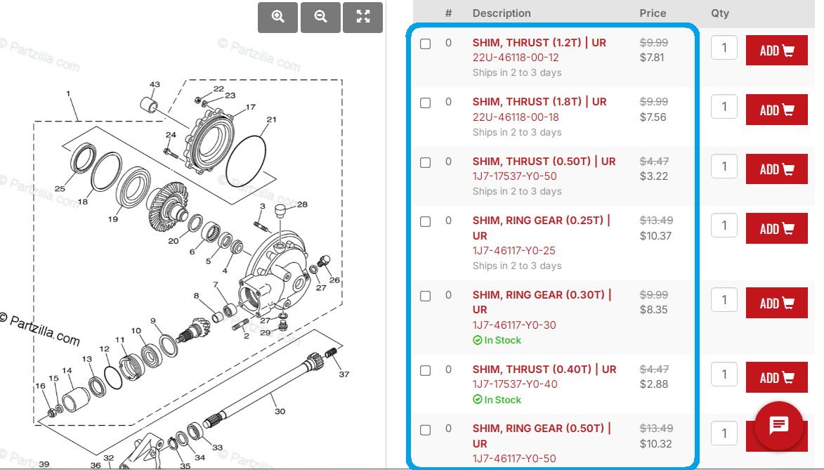

Besides properly filling the rear drive housing with the correct lubricant, if you have any reason to think that the gearsets have been disassembled since they left the factory, they may have been reassembled incorrectly. Individual sets of gears are matched using different thickness shims. Here's the diagram for the rear angle gears: You can see that various different thicknesses of shims are available.
If, some mechanic was to rebuild a gearset using a one replacement gear, for example, the original shims would no longer be appropriate. Similarly, if there were two shims present, but one got left off in a reassembly, the clearance would be excessive. Gears want to be held in precise alignment, with some, but minimal axial clearance for each gear in the set. Same goes for the front set.
